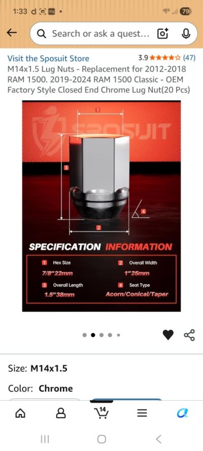

Mpgrimm2, thank you for your help with this. I took off two of my lug nuts to compare. One that is probably factory, because of the chrome cap, and one that is solid metal. Their dimensions are identical. The new ones I purchased are way too small.
I looked at the 66148FS on the Gorilla web site, but I can't purchase them because I am blocked from adding them to the shopping cart, and no one near me sells them.
I found some on Amazon that have the same dimensions as mine. I will order them and see if their dimensions are correct.

28 percent of the few reviews are 1 and 2 stars. Not a good track record for their lugs.

Wow. I looked at so many lug nuts, that I missed these reviews. Well, back to the search. Thanks.
