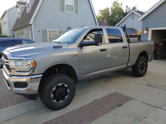

I bought my kit through CJC Off-road. The kit was $700. Their customer Service is amazing and I will buy all my parts from them exclusively. They also have a fantastic YouTube page with outstanding technical info. 04ee0b8283e904956cecff2727e72c29.jpg

I went a similar way but used the Carli Springs with Bilstein 5100 all the way around. Came to almost the same price and install was simple. I had a 2017 that I set up the same way and was very happy over the 60k plus miles I put on it before I traded it for the 2020. Really like the 3.73 gears on the 2020 vs the 3.42 on the 2017.

Truck looks great, Did you need to put a new track bar on to center the axle?
Since I only went 2 inches, the front axel off set is barely noticeable. I might do that in a future upgrade
