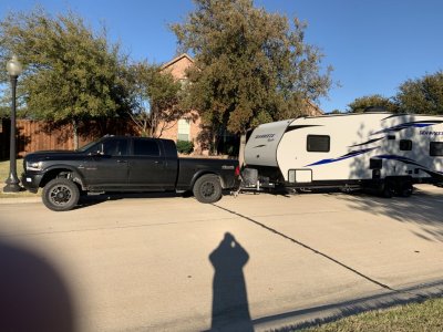

My Thuren's squat pretty good with my trailer...however the rear axle now actually moves which is what I wanted. I have airbags for the time I haul heavy loads.
