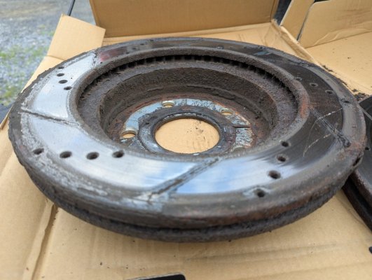

Additionally what I am seeing after 5.5 years in the salt belt is discouraging rust wise.
The rotors are really rusted and the slots have filled in with rust in some spots.

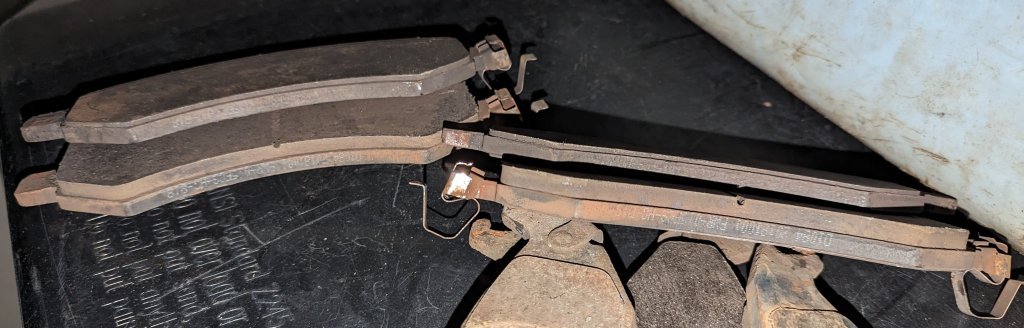

Pic of the pads when I pad slapped them

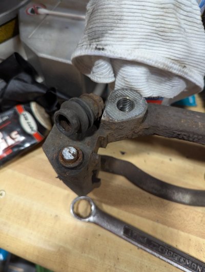

Be sure to clean where all the hardware goes, and make sure the caliper pins are lubrcated well and they move in and out smoothly.
The one pad wearing more can be a sign that the caliper is not moving freely on the mount.

New brakes on, no noticeable difference from the drill & slotted other than brakes seems smoother.
BUT
It's not a fair comparison as the old rotors were ruff and I had a frozen caliper slide (which is odd because they were all fine when I did the pad slap)
Pics, judge for yourself as far as if drilled & slotted rotors are for you "long term" in the salt belt.
