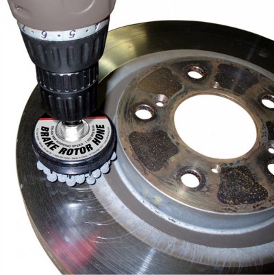

As mentioned, brake vibration or pulsation at the pedal is not due to a physical warping of the rotor but due uneven transfer of pad material to the rotor. This can be reduced greatly if not completely eliminated using a brake rotor hone. They come in a variety of grits and are low cost way to resolve vibration/pulsation:
View attachment 495945View attachment 495944
I might have to look into one of these to see if I can clean up the old ones. Or just to have on hand if I start to get a bit of vibration.
