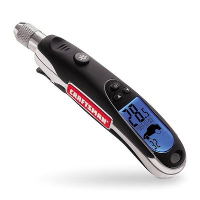

I have this craftsman digital gauge from sears, it reads exactly what the TPMS reads at the same time. They always put them on sale round Christmas for 1/2 price
Sears.com

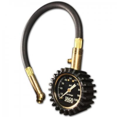

Want a good guage get a liquid filled dial guage. I use one like this.

Make sure you buy lots of batteries. Those Sears gauges go thru batteries like **** thru a goose!

Funny you say that, had this exactly one year and just had to replace few days ago, they are CR2032. I use it all the time so I think a year was excellent.
