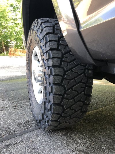

I’m running 315x70x17 Nitto Ridge Grapplers on my 2025 Tradesman/PW package on the stick wheels with no issues
