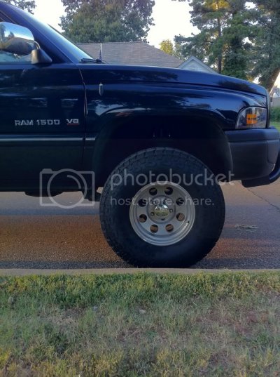

Welcome to RF. Badger is right. With a set of wheels with at least 4.5" of backspacing, you can run 35's with almost no rub. I'm doing it on mine right not. If you do rub, it should be only slightly and just on the back side of the wheel well liner. I can post up some pics of mine with the level and 35's as well as the area it rubs if you'd like
txbass06
Oct 27, 2010
4,129
56
NE Texas
1996
5.9 Magnum

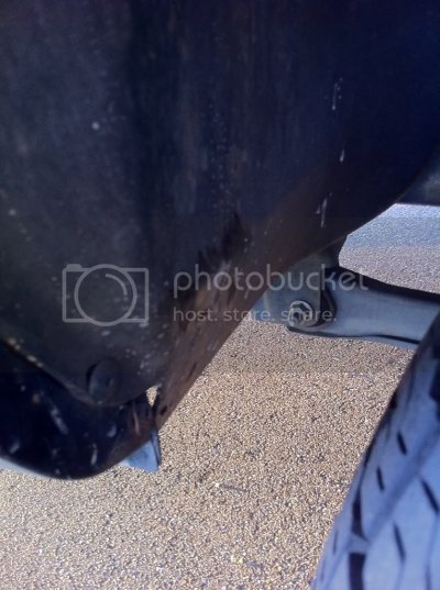

Here a few of the truck
And one of where mine rubs
I ran these tires on my factory wheels and would rub on my upper control arms before full lock. It's the darker spot on the top arm in this pic
B
billy_thekid
Dec 8, 2011
Georgia
1997
5.9 360
that is where mine rubs now with the 33s and no lift. Thanks for the pics that was helpful.

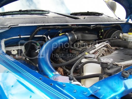

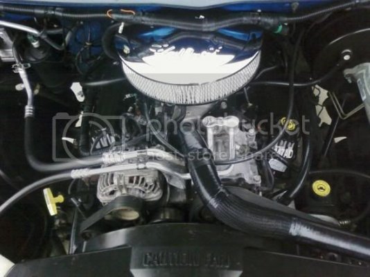

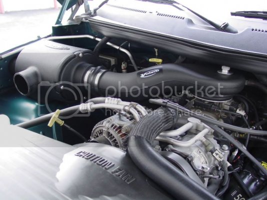

no to the throttle body spacer (paper weights in our trucks). Programmer yes Superchips or SCT. I run superchips but if I was going to do any interanal engine mods I would go with the SCT. The CAI is personal preference. I made mine. Some run the 14x3 and some buy them I think Volant has one that has a sealed inclosure, which is what I would get if I were buying one.
Mine
14x3

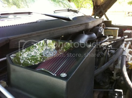

I'm running an S&B intake on mine and noticed about .5mpg gain.
A TB spacer is just a waste of money and won't change a thing on these trucks. There's not many tuning options for the '97s unfortunately. Hypertech makes a couple but they're around $350-$400 and aren't worth it IMO
wermbang
Jun 29, 2010
9,724
215
Iowa
2001 Off Road
5.9L V8 Sport
^^^thats the intake I was talking about
but here is the Volant
