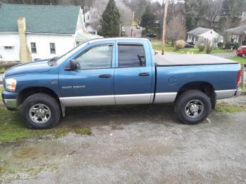

Will it make the speedo slower or faster? I am going to be putting these tires on the stock rims. I figured going with the 285 will have less chance of rubbing than the 295 or 305's

I finally got the Nitto's. 285/75/17 and they look awesome. Plenty of clearance and make the truck look way better than with those little 265's. I ordered them from tirebuyer.com and got em for $850 installed.
