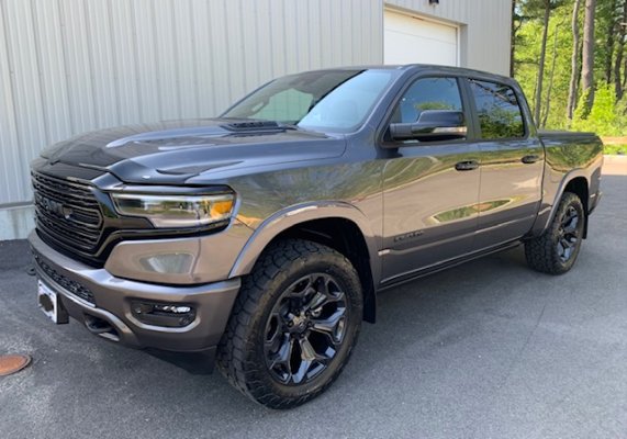

or a 275/65/20 which is about 34.1" tall
I would say Yes on both of the options you're considering...I ran 275/65/20 (34.1 X 11.0) General Grabber A/TX tires on my previous truck which was a 2016 1500 Limited with no lift or leveling kit and had zero rubbing. Plus, with the additional clearance you're getting with the OR package, you should have plenty of room to fit either tire with no issues.

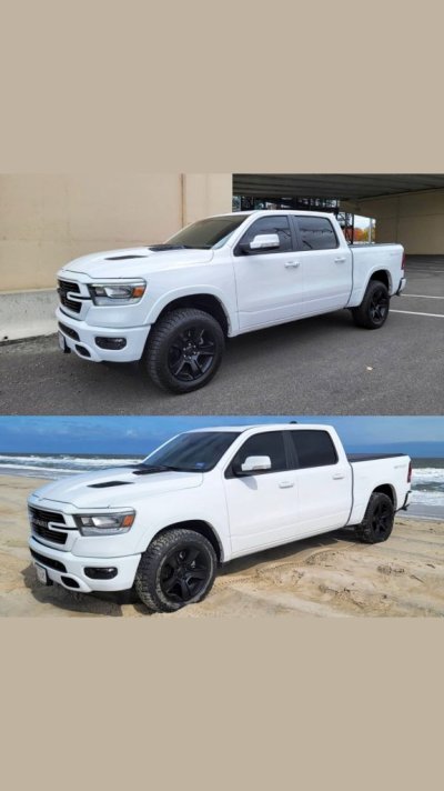

I'm running LT295/65R20's (equivalent to 35's) on my stock black 20" rims for my summer set up (first pic).
The second pic was with LT285/65R20's.
I'm running with 5100 Bilstein's with the fronts set to 2.1" raised and using the stock springs and stock UCA's. No rubbing at all and sits with a great stance.
