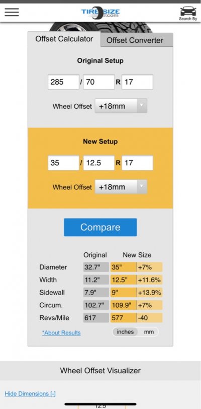

I have a 2016 rebel. I know 315/70/17 fit without rub or trimming.
I am considering that size or 35x12.5x17 on stock rebel wheels.
Will 35s fit? Will I need level links?
What about spacers? I am wanting to get the rivet OEM flares are some point too. So would like a 1.5” bora spacer be a good idea?
I feel like level links will give me height to clear. 1.5” bora spacer would keep things from rubbing.
Bigger fender flares would be filled out nicely by overall package and give truck nice stance.

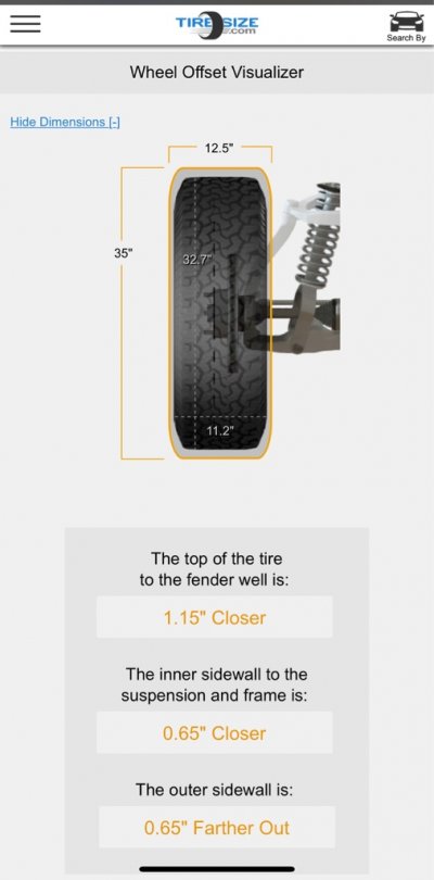

Here’s the only calculations:6f72bc3f35ae0aadbfa09a9929671603.jpg
Thanks in advance.

I'm thinkin you'll have to do both. Level and spacers. But maybe you can get away without spacers. But a level is a must

I'm running 35/12.5-20 on my 2500. I had to do a 2.5" level on it. Oh yeah my wheels are 20x10 with a -18 offset

After doing more research I think I should just go with 315/70/17 on stock rims and save myself some headache with trim/rub possibility. All my research shows people are fitting this size no issues.
I can add links to lift slightly if I want to. Can add spacers If wanted.

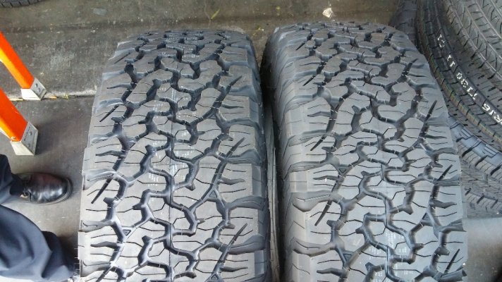

315/70/17 are pretty much the same thing as a 35x12.5x17
a 315 is just a smidge wider, the 35 is just a smigde taller. How much?
see by yourself
Both are BFG KO2's
The one on the left (shoe in pic) is 35x12.5x17
the other on the right is the metric equivalent 315/70/17
If you think the 315's will fit, the 35's will fit pretty much the same
You only need 2" lift to fit either size.
