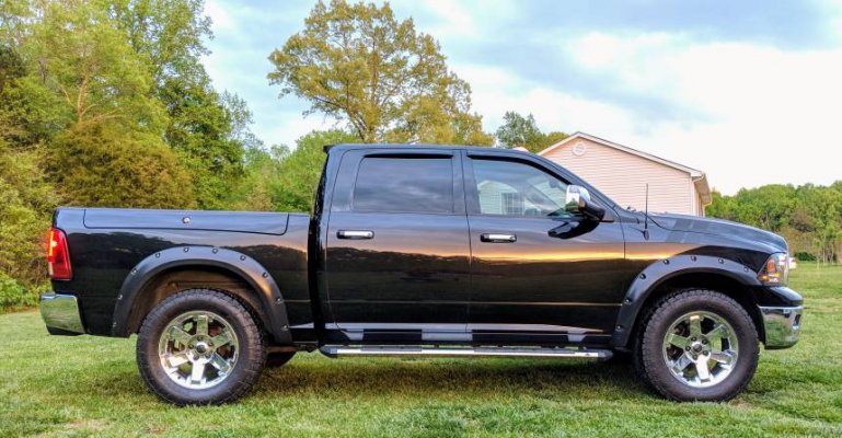

Front level 2.5" and running Nitto Terra G2s 35x12.50x20. only slight liner rub at full lock but nothing harmful. Also have a 1" TGC coil spacer in the rear.19e658521ead700613adcdf07e6a3ed3.jpg
