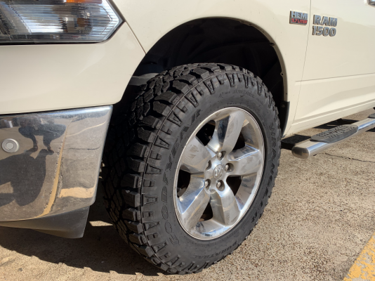

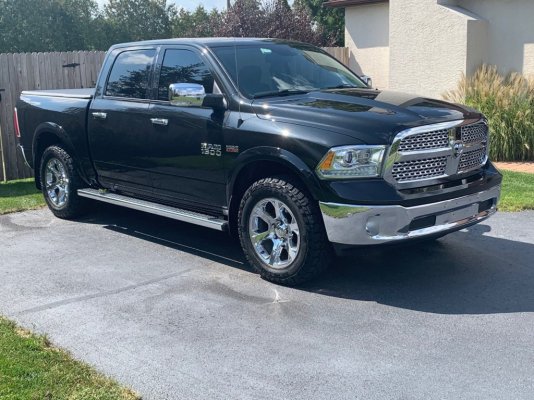

34 to 34.5" tall. If you plan to do any off-road you may want to stay at or below a 34" tire. I'm running Milestar Patagonia M/T 275/65R20 that were on the truck when I purchased it and they look stuffed (34.3").

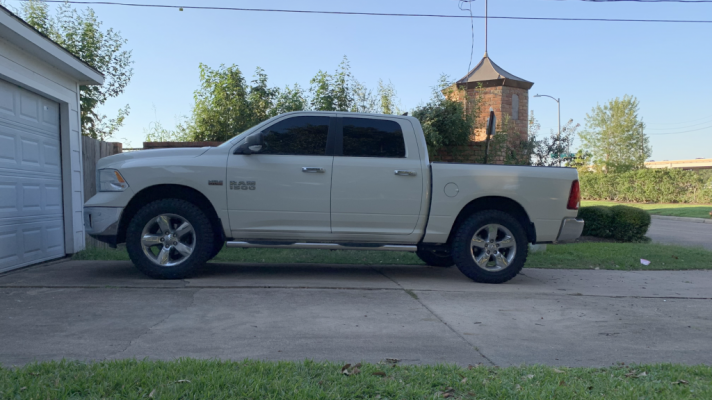

You are gonna rub at full turn with a 12.5 wide tire. I have 33x12.5x20’s and I love them, but I also run a 1 and a 1/2” spacer and am leveled. Stick with the 275/65/20 as mentioned above if you want a tire that appears larger than stock but doesn’t rub.

No, you don't need a leveling kit to fit 275/65R20.
