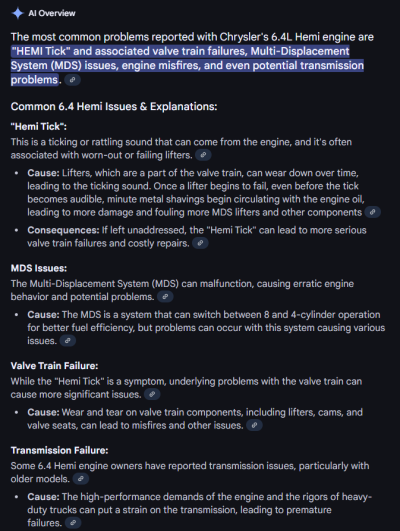

Hemi Tick is so famous even the all-knowing Google AI Wiz picked it up! lol
