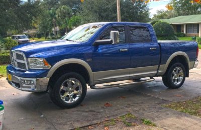

I have the 2.5 HBS setup on mine and love it. Just did an inspection tonight as I am installing Suspension Maxx end links and everything looks good. Have over 10,000 miles on mine. No problems yet.
I haven't done a rear spacer because I tow regularly, but I'm debating it. It will depend on a few factors, such as sag and if I get springs or not. Right now though, you can see in my sig, my truck towed still doesn't sag. And it's leveled. Love it!
For extra appeal I removed the lower black air dam. You'd be amazed how much it changes the appearance of the truck removed.
I think the next thing I'm going to do is 275/65/20 tires because these Goodyears blow monkey chunks.
