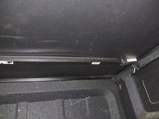

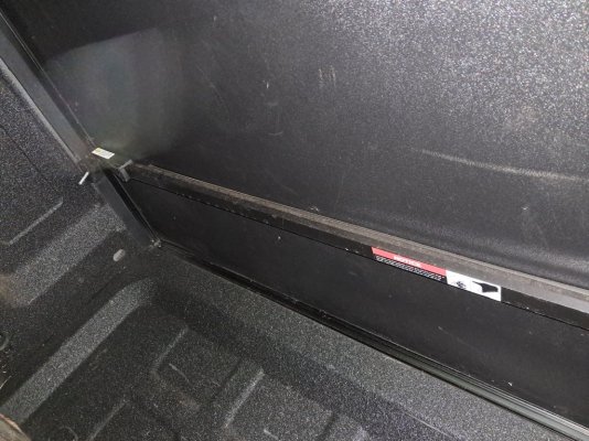

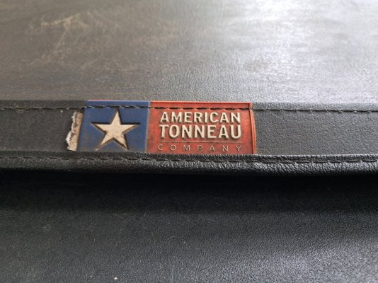

I have a 2017 RAM 1500 5.7 L, 4WD, 8 foot bed. I believe the tonneau cover is American Tonneau Cover 76203. I can't find any internet listing for American Tonneau cover parts or an American tonneau cover website. This area has been broken since I bought the truck from the dealer 2 years ago. Do not know if tonneau cover is factory OEM or aftermarket. I need the cross member and attaching mechanism for the rear of my tonneau cover. Any help, suggestions, home fixes appreciated. Thanks

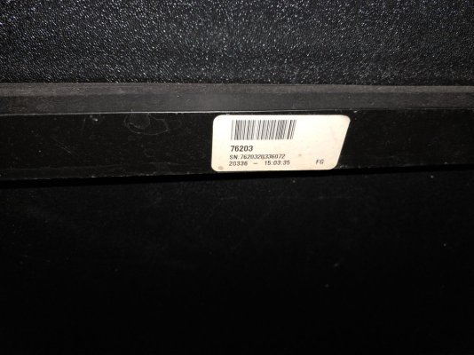

Part number, no mfr label. 76203: internet indicates American p#

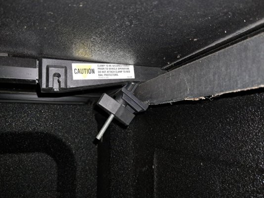

Cross member at front of tonneau cover. intact and functional
Missing cross member and hold down clamp, rear of truck bed

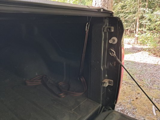

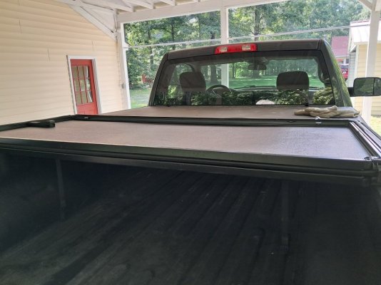

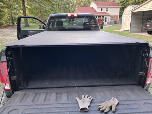

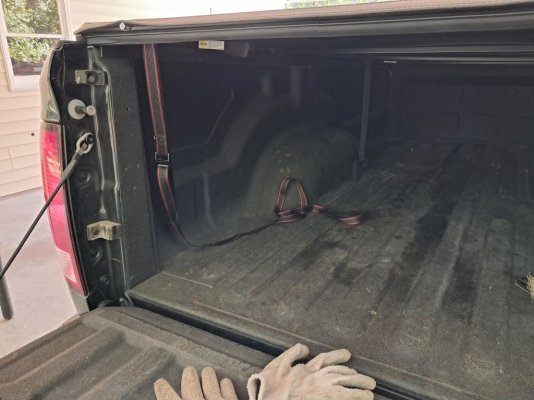

Fixed 2 weeks later and forgot to post pics.
Bought eye bolts from Lowes, $1.50 each.
Drilled holes on rear x-bar of tonneau cover.
Straps I already had and 2 carabiners.
