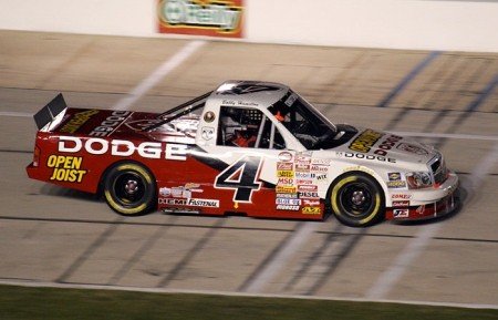

I call bs on the tonneau cover increasing mpg as well - if it were true guys would be running them at the track

Nah, it doesn't make a difference. That's why these trucks beds are flat on top.
Those trucks are also a one piece composite body, to simplify the design they don't design a bed into them. You'll notice the air deflectors on the 'tailgate', they're positioned perfectly to catch the stream of air that comes off the cab and push the back end down, which is more important for the truck's handling at the speeds they drive at.
The length of the 'bed' and the location of the 'tailgate' is a more important design factor than if the bed is higher or not. In trucks with beds, you WANT your tailgate up because it generates a rolling vortex in the box and pushes the main air flow over the bed and reduces drag behind the cab, this happens to a much smaller degree with a hard tonneau cover but is less affected by a soft cover that will deflect and allow a larger rolling vortex.
If you want to increase MPGs in a truck, every thing you need to do should be geared towards that end, lower rolling resistant tires, smaller mirrors, front air splitters, remove the bug deflector, decrease overall weight, things like that, you might even pick up 0.5mpg with it all.
