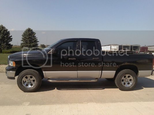

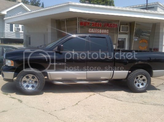

i just cranked the torsion bars up on my truck the other day, raised it up a couple inches. havent had it aligned yet though. torsion lift keys are kind of a waste of money imo. you cant get any more lift out of them than you can with the factory keys i dont think.
BLKDODGE04
Sep 1, 2012
838
50
Wataga, Illinois
4.7 Magnum
before i cranked the keys...
after...
not so sure the front sits up higher than the back now...

Measure the fenders and see. The top of the hood body line is higher then the bed top so naturally makes it look nose up. Mine with keys when they were on along time ago made my truck look very nose up when leveled and under a hard take off unloaded the front way to much. The 04 now has just a few turns in it, the 05 has a few more for a better stance. Deff get it aligned after you do either.
