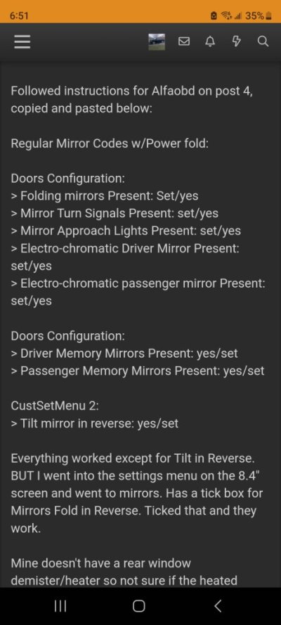

I just removed tow mirrors and installed regular folding mirrors on my 2024 warlock 1500 classic.
Below are the things I had to do in alpha obd for the bcm to recognize the mirrors. Notice the 2nd and 3rd item. Have you looked into or enabled these in the bcm? We're they enabled previous to your install?
I'm not certain what mirrors you had previously but, I also had to change door modules it order to make the mirrors work.
I have not enabled these in the BCM. And they would not have been enabled with the previous mirrors on the truck I’m assuming as they did not have the approach light/turn signal light on those mirrors. Thank you for sharing them.
