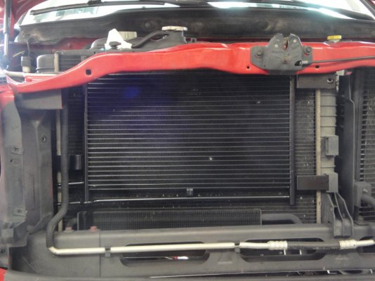

Brake controller wasn't available from the factory until well into the 4th gen run. There is a connector under the dash in 3rd gens and tow package trucks came with a pigtail in the glovebox for it. All 1500's come with a trans cooler but there were 3 different sizes. The standard 1500 non-tow is relatively small, then there's a medium size larger one followed by the gigantic 1 ton cooler.
Standard non-tow 1500 trans cooler:
1 ton cooler:
The mid size is halfway between the two.

Dayum. That's one huge trans cooler. At that size, does it affect the radiator's cooling?
Nope, just affects how well the trans gets cooled. Especially helpful if you have a higher stall converter (I did at the time).
