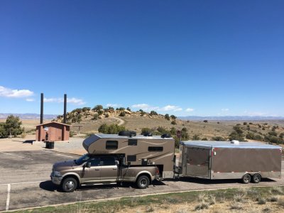

I wouldn't even consider it unless you have a Dually. Even then you want to keep everything as light as possible.
Torklift will be your best friend for all things Truck Camper.

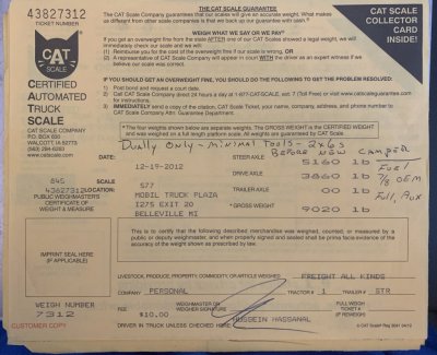

F659C3C2-3092-4975-ADE1-37E48D987DCA.jpeg 19D02885-2FC2-4E2E-8DA2-41D93722BF33.jpeg

What is that scale ticket from? That can't be your truck.

My camper was all aluminum, frame and interior. No wood at all.
I weighed the dually before and after I picked up the camper. It is a 10' camper.
