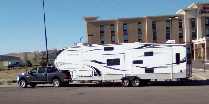

With a 7700lb 5th wheel and your 2500 diesel you have nothing to worry about. When I tow our 7500 ln trailer I can barely tell it's back there.
I tow our 40 foot 14k lb 5th wheel with no problem at all.
