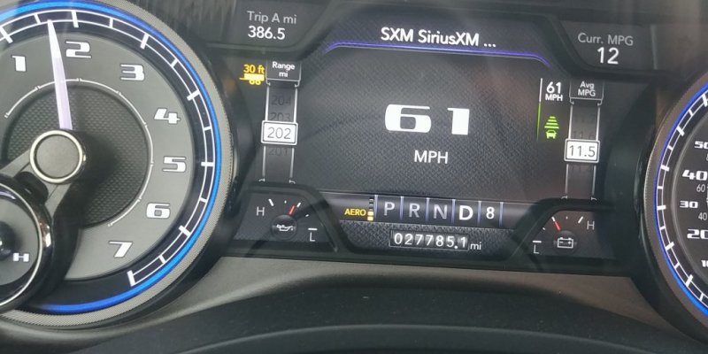

That's about right. I seldom use tow haul unless in really mountainous terrain. Even when towing heavy, I see no advantage .Dash display.jpg
