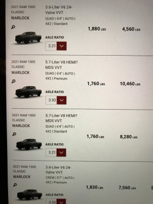

IMG_2714.jpg This is taken straight from the RAM site.
A V8 Hemi with a 3.21 is rated for only 750 pounds more than the Pentastar with a 3.55. Would a Pentastar with 3.92s pull as much as a Hemi with 3.21s?
A Hemi with 3.92s is rated to pull 2180 more than the 3.21s.
I love this. To you it's proof you need 3.92's, to me it's proof the "one specification" tow ratings are completely useless. You have a v8 with 110+/- more HP and 130+/- more lb/ft of torque, and you think it's only capable of towing 750 pounds more than the v6 with a 3.55? Why, all you need to do is drop 4.30's in that v6 and now you can tow the same as the hemi with 3.92's!
Think.

Getting a load moving is one thing. Controlling the load while moving is different. Stopping that load in a controlled manor is another set of issues.
Compare weight ratings are f the tires and see what differences are there.
