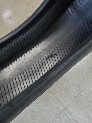

Had a nail in my wife's Honda that caused the right rear to lose about 1 psi per day. It never went flat, but tpms warning at about 28psi, down from 35. Took the guy at the tire shop 15 minutes to find it, and when he took the tire off the wheel, they said they couldn't repair it, the angle was too shallow. That wheel is off getting a new tire now.
