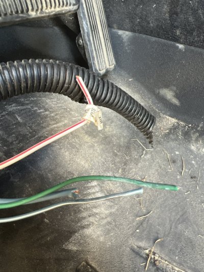

Howdy everyone! The OEM trailer brake controller plug looks like to be cut off from my truck. Wanting to know which wires are what so I can add a brake controller. The wires I’m referring to are under the dash. Ive got a 1) big solid blue. 2) blue/white. 3) green/black. 4) white/red

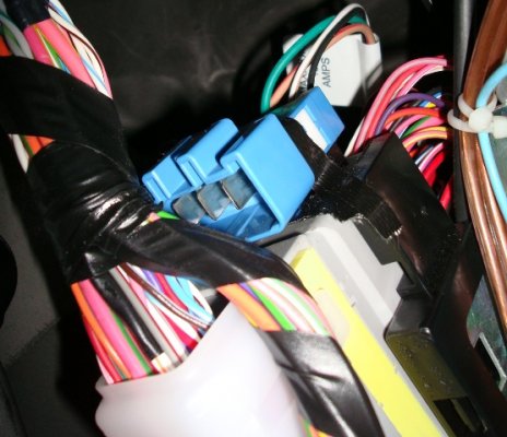

There should be an empty plug (female) for adding an aftermarket one, unless you're saying yours has been cut out?. Looks like this:
Yeah. That blue plug is missing. But I have 4 wires that are taped and loomed together that go to my Bluetooth plug lolimage.jpgthis is what I got. Basically just need to know what colors go to which on the controller side so I can solder them.

Neither the 03 or 05 service manual show those wires as being part the trailer brakes

You need to trace those wires. WT/RD doesn't even appear in the service manual.
Can you flatten out that tag and post a picture of it?

I figured it out guys. I’m an idiot. It’s just a jumper harness. The blue plug wasn’t in the slot like it’s supposed to be couldn’t see it just from poking my head up under there.
