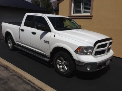

My 2015 outdoorsman didn't come with the brake controller, my fault for not including it in my order. What would be involved in installing it in the blank space in the dash? Thanks in advance
