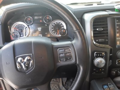

It's Working so far. No service 4x4 lights yet!!
So you are essentially able to lock the truck in 4WD, none of the bs about "ramping" or waiting for the rears to slip?
Precisely. Lou was in fact right about the ball and cam when I have the clutch packs locked up I can feel it lock hard from. Foreward to reverse or vise versa but she is locked up. Difference isn't huge but it is definately noticeable and it turns the front right away none of this wait for it garbage. I'll do some more testing on this. I definateky would not reccomend driving around like this all The Time as they are just clutches. If you're like me you like to see how far you can go and it's usually too far then 4x4 goes gimp lol

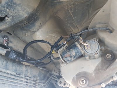

I was thinking I need to find the stock doge connectors or ones that will fit and make this a direct mod no cutting splicing or anything needed and no footprint of it ever being there. It'd just be a mount switch pick up power and ground and done. ;)

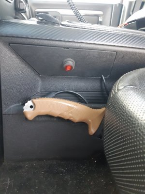

So it's 100% in now everything wired I'll let you guys know if I have any issues rite now but as it sits it seems like it's going to work!! It does seem to dig Alittle better, my tires have had better days though so it would do better for someone with winter tires. Super happy this turned out!!!

Electrical isn't my strong point, so essentially by hitting that toggle switch its forcing the clutches to engage and giving you constant front driveshaft engagement? Am I understanding this right?
