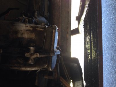

Here's a couple pics where you can see the fluids

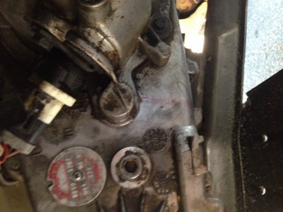

Here's the other one

That is the transfer case not transmission. Most likely shaft seals. Check T/C fluid level. That doesn't look too bad just watch it.

**** yeah...that's the tail housing seal on the t-case that's shot. That's why your trans. fluid level was fine. Like RamV10 said, check the fluid level in your t-case.
