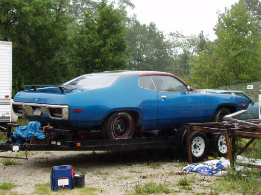

I miss my Road Runner the most. Found it at an abandoned house, gave my number to the neighbor. Got a phone call like 3-4 months later. $500 plus a **** ton of OEM parts but had to get it within 3 days (this was back in '96 before Barrett-Jackson & Mecum ****** up the hobby). SOLD! Found another 400 to put in it, had to rebuild the wiring harness (PO had a small block in a big block car and hacked up the harness accordingly). Local u-pull-it came in very handy. Was my daily for 2yrs, engine caught fire. Put it in storage, then got stationed all over the place. Decided to sell it since it would be a good long time before I was somewhere I could do something with it. Didn't wanna be that guy....was a sad rainy day 13yrs ago when I watched the guy load it...[emoji25]
