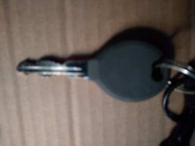

I had two working keys but one stopped working I believe it needs to be reprogrammed. Is there any way for me to reprogram it myself with only one working key? My truck is a 2002 ram crew cab.

No. Is it a SKIM (chipped) key or are you referring to the FOB?

It is a chipped key. This was actually the spare that I use now the other one is black with the ram logo. It failed and would only start just to die a half second later. Switched keys been running fine every since with spare. I think it needs to be to reprogrammed I don't know why it would fail all of a sudden but I did have to jump start my truck after leaving the dome light on thought that was a possibility

It came with one black one grey how would it run both keys if only one was chipped. I used the black key for months. I am certain they are both chipped

Either you don't actually have SKIM or the gray key was in close enough proximity for the black key to work. Regardless, facts are facts; gray = chipped, black = not chipped.

This is a screenshot of .y vehicle equipment pulled right off the Mopar website. So so it does have the security system and I'm only going to assume that they are both transponder keys otherwise the first one would not have been working for the seven or eight months that I've been driving with it now I just need to figure out how to get it reprogrammed or replaced.

Dealer or locksmith who has the necessary software, unless you know someone with DRBIII or DRBIII emulator software. If you find yourself in MD I'll do it for beer or a small donation (voluntary of course) to the speed parts fund lol.
