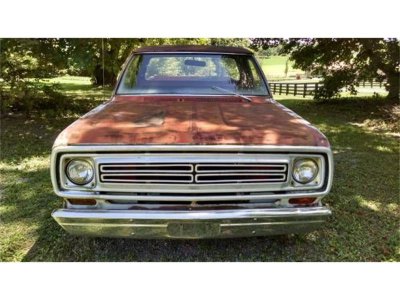

A friend of mine needs a 72-3 dodge truck grill if anyone knows where a good one is let me know please. Here's a picture of what he is looking for.12746633-1972-dodge-d100-std.jpg

probably better off to try posting on facebook in the tin grill or dodge groups. the 70's grilles are more difficult to find since they made so many change so often.

if it doesn't specifically have to be a 72 grille, they will interchange up to 1976. expect them to be very expensive though. ebay has a few for $100. better condition ones are 300-400 bucks.
the 77-78 will also interchange but then you have to move the front turn signals into the grille and use the 77-78 front filler panel below the grille. the 79-80 grille won't work without the 79 headlight bezels/cups.
I got lucky in my local pick and pull had one last old 78 dodge. pulled the grille and filler panel for under $100. I'd check there too if you have one near you.
btw, search ramcharger as well when you look.
