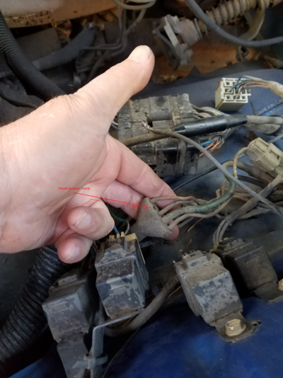

howdy been awhile sence ive been here.... now to problem, 1992 dodge d150 318 engine ... was driving down the road when she start spitting like she was running out of fuel so i stopped and put it a couple gallons ok. Fired her up and took off down the road about 1/2 mile she just quit running no power to ign switch no power to windows no power to signals , BUT do have power to head lights and flashers.

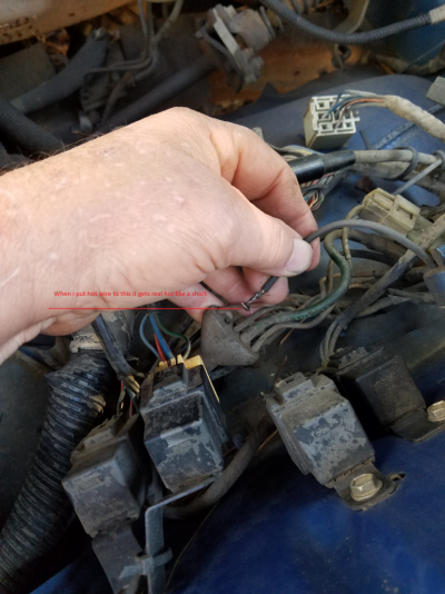

turned the key to start her up nothing no power to switch.. ok so i got her towed home and started my search found a wire that had burnt of a connection of some sort ok.. so this connection has power ok... so i reconnected this wire and it started shorting got real hot real fast.. now i dunno what to do what else to look at . ill post pics of what i found.
help i really love this truck but dont know where else to start looking....

whatever that is connected to is shorting out/or bad. can't you trace the wires to see where they go?
if you leave it disconnected, what doesn't work? (other than the truck)

that wire splices into a big red wire that has one more wire spliced into it like a Y the big red wire goes to the firewall inside some place under the dash.

no but it could as it is attached to the other two wires the other two wire are smaller so they would burn first.

ugh....you're gonna have to trace those wires , or, put a meter on each one and check them to see if one is grounded out. i use a meter with needle point connectors, that way i can just ground one wire then push the other into another wire without cutting it.
evidently, one of those wires is shorting out. don't have a wiring diagram, but, maybe someone does in here.

People who don't have a good electrical understanding are easily frustrated. Not having a schematic is self-defeating.
(P.S. Not sure, could be a fusible link)
