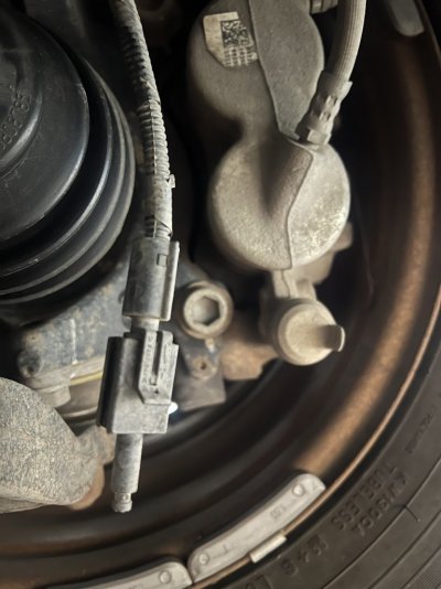

I have a similar problem, I’ve read your threads and went underneath and found this hanging by the front drivers side CV axle. What is it ? Can anyone identify this please. It’s a 2019 ram 3500 box truck. And also a piece of string or something wrapped around the brake caliper (photo#2)

Looks like your wheel speed sensor was pulled out of its home by that string. Look at the other side of axle for its proper location.

Image #1 sure looks like part of a Wheel Speed Sensor
Image #2 looks like someone tied the Caliper up & out of the way, while doing a brake job & they just cut the line to remount the caliper
or
they tied something else up out of the way & fastened that to the caliper
