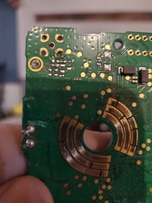

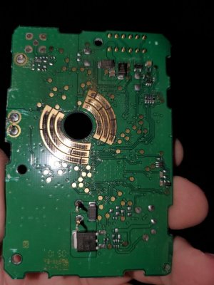

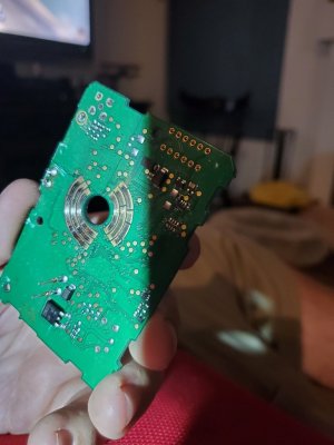

Last update for future searchers. I did an autopsy on the old win module and it had clearly failed. You can see in the photos that the part of the circuit board the key makes contact with when you turn it was completely worn through to the board, and that a chip on the top left of the board appears to have been fried. I won't be posting anymore about this but I wanted to conclude with pictures of what a bad win module looks like. 20210126_201112.jpg
