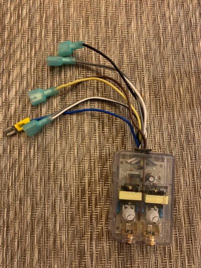

I’ve got a 2015 Ram 1500 Big Horn 4x4. I’ve got a JL subwoofer and a Boss 1500W amp that my brother gifted to me and am trying to figure out how to get the speaker input into the amp. I have a high output converter and don’t know where to tap, or which wires to tap into to install it. Any help?

You could search on the site but it seems most people use the rear speaker wires to tap into for subs. They access the speaker wires behind the trim piece between the front and rear doors. You'd have unwrap the harness to find the leads. On my 2018 the wire colors were:
Right rear, + purple, - purple/black stripe
Left rear, + green, - green/black stripe.
