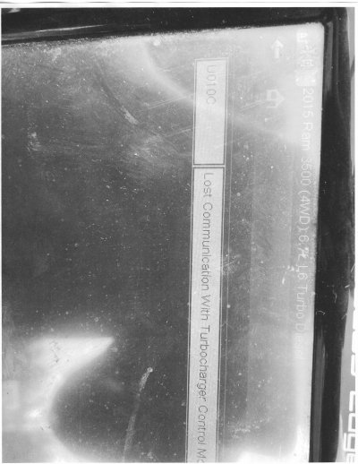

the truck is a 2015 ram 3500 DRW with the cummins 6.7L diesel engine. i've attached a copy of the letter that i received from FCA. i went to the dealer and asked them about the letter and they claimed no knowledge. they did however search their database and found a brand new service bulletin about the issue. they gave me a copy and i have attached the front page of it. i also attached a picture of the scanner error code that i was getting.
when this happened last year the dealer replaced the entire turbo charger. the new service bulletin say the FCA will only refund the cost of replacing the turbo charger actuator. but this service bulletin was not in existence the entire turbocharger was replaced. so i am going to argue for the full cost of the turbo charger replacement. let's hope!!!
