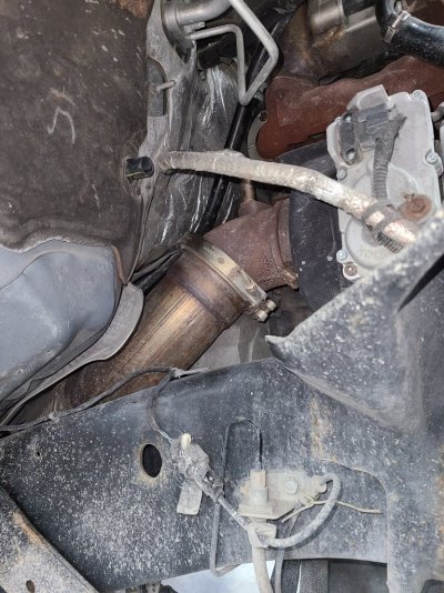

carguy79ta
Dec 11, 2021
united states
2013 2500 outdoorsman
6.7 cummins, 200 hp tune, fleece turbo
I know this thread is old but I installed a 5" turboback SP. Thru the fenderwell. The turbo is right there. If I was to replace the turbo that is how I would do it.
