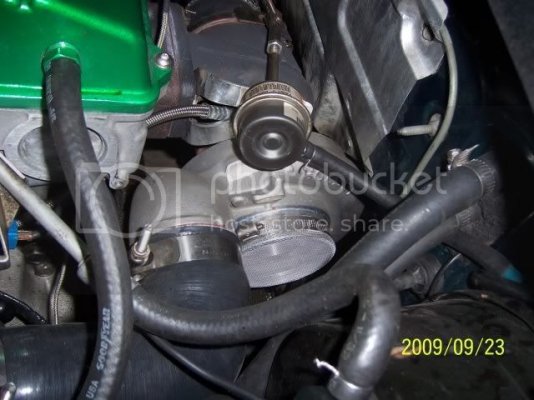

i know quite a few that have out them on our cars. they are 2.2L turbo dodges and they are by far they cheapest setup for our cars. 8V and 16V 4 banger turbo cars are running them. my buddy runs 37 PSI on his stock bottom end car and is in the 12's running running rich A/F ratios. he keeps up with stock vipers!

he was asking if it would work on a gas engine. i was just letting him know it has been done. FYI, we use the HE351CW. there are bigger ones that should work but at 37 PSI im sure he doesnt need that much boost
