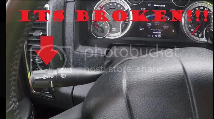

Had a strange issue with my turn signal not returning to center on left hand turns. Was worried it would be something to do with a clock spring, expensive or hard to fix. Ended up being REALLY simple.
Tried opening up the old stalk and greasing/inspecting but still kept hanging. Ended up grabbing one off eBay for $35 and works like a charm!
Video on issue and how to fix!
https://youtu.be/INU8n9yK9rc
