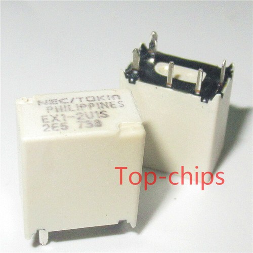

You might check or swap a couple of the relays on your fuse box. Or replace if they look corroded. The TIPM's can corrode too for those who live in the rust belt. I ordered all new relays a while ago for mine (fuel pump relay needs to be soldered on the TIPM). I haven't received or installed my fuel pump relay yet:
Main cube relays:
Fuel Pump relay:
Or there is the fuel pump relay bypass cable (solder-free):
Read the SYMPTOMS portion of the last link below and see if that fits what you are experienceing. A lot of guys do have fuel pump issues and there is a restoration process (or reconditioned TIPMs for this issue). And enough that they make a bypass cable. Mfgr life expectancy on the relay is 100x10/3 (to the third power), which is 10 million cycles. If you started your truck 10x per day for 20 years, that would only be 73,000 cycles. If you started your truck 100x a day for 20yrs, you still dont scratch the surface of even half the relay's life. But in the real world people are having failures esp the 2012's. I think it would be a good idea to remove the TIPM and have a look at possible corrosion issues and you could even swap the fuel pump relay with another on the TIPM board to see if that resolves the problem. And of course look into the switch.
