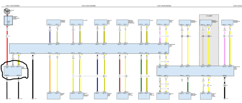

As you can see by the CAN topology map here:
The ALDL (obd2) that I circled in black, is connected to the CAN-C star connector, where everything else is connected as well.
So, if you can't scan at all, and there is no communication between the scan tool and the CANbus network, it sounds like the CANbus network is down. It could be down due to a wiring problem, or a module bringing down the network.
Or, if everything I just said sounds like a Japanese love story, then you should probably start looking for a shop with a good rep for fixing electronics issues.
