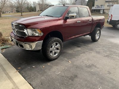

CB50B445-9B6C-432A-B689-05FB191AA0E0.jpeg 6C732CB5-6011-481B-8491-86C696CE1EFF.jpeg So the trucks current setup is^^^^^
ProComp 6”
No preload spacer with Bilstein 5100 @ .7
20x8 stock wheels
35x11.5 ridge grapplers
Now here comes the multilayered questions about the changes I’d like to make to the truck.
I want to do the following:
Adjust Bil 5100s to 1.4 To get some rake out of it
1.5 or 3” body lift for a little more height
17x10 -24 wheels
37x12.5 tires
Now onto my questions:
ProComp says I can’t run smaller than 18s, but then again I think a few other lift companies say that but then you see examples of people running 17s.
ProComp makes a blanket statement of “18s with no more than 5’ backspace”...........would my above described wheels work on my ProComp kit? Why do the loft companies say no 17s yet I see some guys able to do it on these same kits??!
my last question: regards to the body lift, is there anything other than what comes in a PA 3” kit that I’d have to get to make it work since I’m combining it with a 6” suspension kit?
Any help is greatly appreciated.
