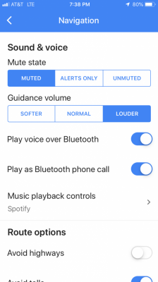

If your in Apple Maps, go into your phone settings and make sure the sound is turned on for it. If you’re using Google Maps, go into GM’s setting and make sure it’s set to play as bluetooth call.

I have the first screen in my iPhone but I can’t find the second screen you posted
The second screenshot was in the navigation settings located actually in Google Maps. I assumed from your post that you were using Apple Maps. However, if you can’t get AM to work properly and wanted to try GM, then the second screenshot is what you would look for to have the audio play through all of your inputs (radio, SiriusXM, etc).
Hi. I just realized this morning it was for google maps. I did adjust those setting in google maps and will try to see if that works. I prefer Apple maps and haven’t tried google maps yet.
Google maps worked with voice commands through the radio! Awesome. Thanks guys for the suggestions. Now I have to get used to google maps.
