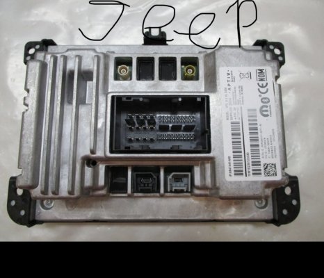

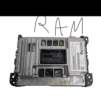

So ive been looking for a carplay 8.4 uconnect and all the ones ive seen are $900+ for a decent conditioned, and i waa looking at other 8.4s and saw that the Jeep Cherookee DL radio has the exact same mounting points as. would it be possible to use that jeep radio onto the ram or would there be a problem?

**Update** After three hours at the dealership and $300, the tech found a bent pin on the antenna connection. Were it not for that, I’m pretty sure my upgrade would’ve been plug and play. Everything (climate control, phone, nav, XM/FM/AM) now works on the new-to-me radio.
The $300 is what I was quoted just to flash the new trailer brake controller, I added while replacing the radio, to the truck. Guess I got 2 1/2 hours of diagnosis/labor for free.
Original reply:
I think they’re interchangeable but maybe someone with more knowledge will chime in.
I replaced the 5” in my 2015 1500 Tradesman this morning with an 8.4” from a 2017 Cherokee. I have everything working except XM and nav. Error message on XM screen is “Check antenna. See dealer for service.” I’m hoping I just didn’t quite get the antenna plugged into the back of the new radio.

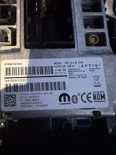

so today i did it and climate works and everything just that the radio doesnt turn on it gets warm but nothing

Post # 3881 - Good Info on 4th Gen Ram Panasonic 4c Internal Hardware PNs vs Mopar PNs
(APTIV/Delphi/5th Gen radios aren't fully compatible with 4th Gen trucks)

dang so its best to return this unit? everything works except the radio
climate buttons work except ac and circulate but if i connect my ra1 the work again
