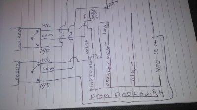

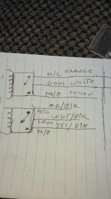

Okay I'm finally back sorry for the delay but I've been working just way too many hours but anyways pulled the switch out and here is a picture of it there's obviously more than four wires here so I will let you decipher if it's the three wire setup or four
And this is my modules relays.
Sorry about the lowsy drawing

You have power windows. I forgot to ask about that. Some of those wires are for the power windows.
I'm a bit tired and worn out from and engine and trans swap/partial rebuild. I'm not sure what the common terminals are connecting to though. I say try it, if it doesn't work, you blow a fuse. I'm going to speculate and say you have the base model, but the easy way to tell is to look at the CTM, the base version has one connector the highline/premium version has two.

Yeah sorry. Bad drawing. The commons go to the lock/unlock wires on the body side of the harness . I wired it up and it works perfectly. Only thing I may change is to hoik up the power window close wire so the windows automatically go up when I lock the doors

Sorry thought I had replied, but i guess it never posted.
Anyways the commons are going to the lock/unlock wires on the ( body side) of the harness
Here is a much better schematic.
Once again the only wires shown are the ones being used . There are obviously more wires but we are only concerned with the ones shown.IMG_20170131_221255.jpg
This worked for me, but for anyone doing this themselves perform this process at your own risk. I'm not responsible for any damages done due to not knowing what you're doing. You should have moderate comprehension of basic electrical circuits before attempting this.
