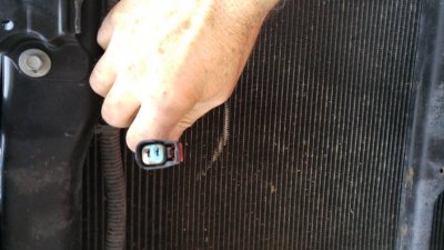

I traded 2012 outdoorsman in for a 2013 slt lonestar edition. i removed the grill and found this plug just swinging there, can nybody tell me what its for?

Hood latch if you have remote start.

hmm, its corroded like it was plugged into something, but the keys i got with the truck dont have remote start buttons?

I you have remote start, this would plug into a sensor that monitors if your hood is open or not. Open it will not remote start, if its opened when its running from a remote start it shuts the truck down.
