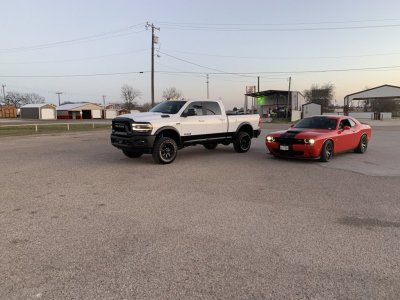

Photos of my PW next G90, Viper, Challenger ... Challenger is my Dads 6.4/392. Ridiculously fast with crazy torque.
THat car sparks all those thoughts. Was driving it earlier ... had me looking at long headers on plane ride home ...
A4E85DA0-9229-4F16-B960-14A55971D681.jpeg6261F551-9E5F-4703-B1F4-235C0B82DBA1.jpeg2307A4E5-D75C-473A-A884-E44F50206E6B.jpeg

View attachment 193700View attachment 193701View attachment 193702
Headers could make my mod list as well. Your dads car squeezes like another 50 ponies out of the same displacement we have on our engines.

I will have to find his dyno sheet ... it is close to 680 at the wheels with an estimated 15% back at the crank.
To tune the car and bypass the cat sensors, a new ecu had to be bought and tuned.
Long headers are going to be minimal without a delete and a tune, but AR claims average of 25 HP with headers only.
I am not ready to tear into mine to the extent he did on the challenger, but honestly this truck is not a racer ... on the other hand, who wouldn't want more hp and torque?
I am happy with my current exhaust and will most likely put a cai on with a wider TB when they have been on the market for 19s a bit longer ...
headers/tuner/cat deletes ... requires more thought and dollars
