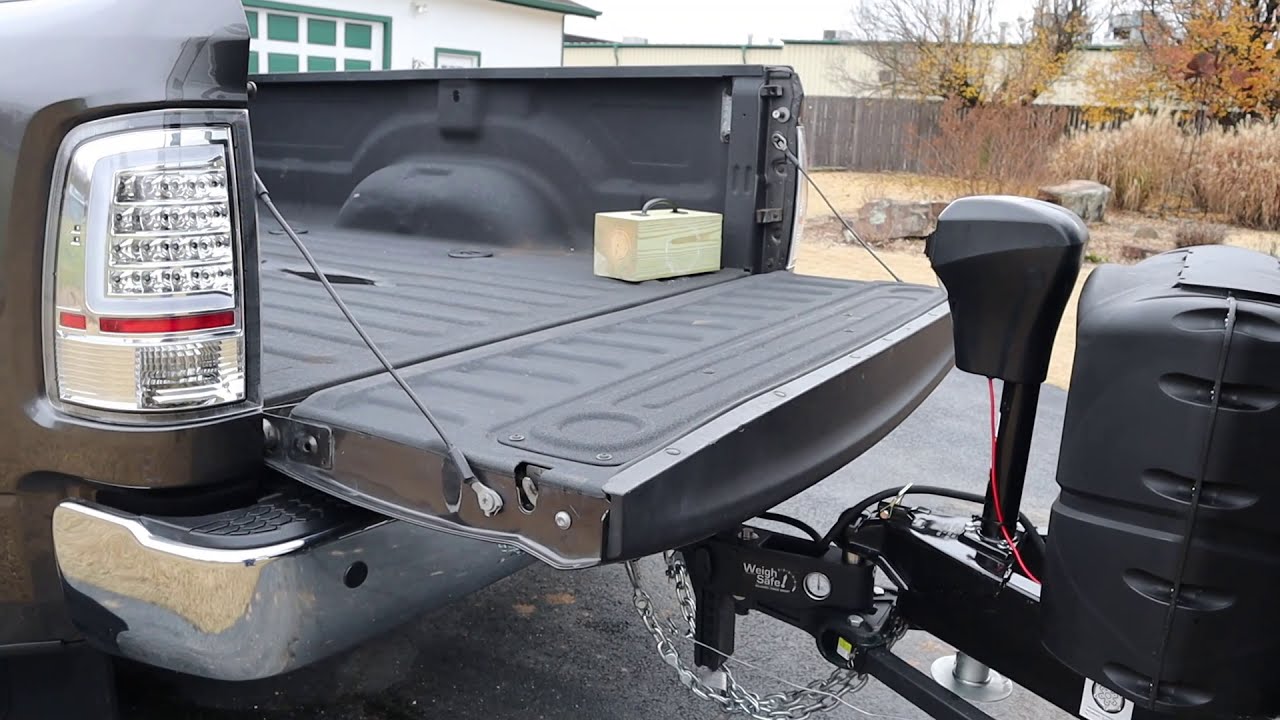

Now that I've had a chance to tow with this hitch a few times down the highway I figured I'd give an update.
The weight distribution part of the hitch is great. I always know what my tongue weight is and it's easy to adjust the weight distribution.
As far as the anti-sway aspect goes, it's good. I don't think it's as good as my old Equalizer. Maybe close to the same but not better however it still works. The bars do not sit flat on the L bracket. They are at a slight upward angle going from front to back. The L bracket install height measurements are dead on as per the instruction manual. I honestly don't remember if my Equalizer bars sat flat on the L bracket.
I'm not sure if the finish is painted or powder coated. It's a textured matte black finish. It comes off easy where it rubs metal to metal. For me that just means I need to clean and paint it once a year.
If your thinking about getting one I'm still happy with mine and would recommend it.

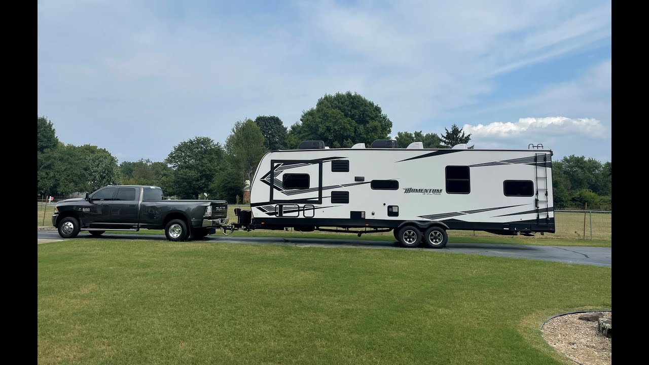

We tow quite a bit heavier. 1700 to 2000 lbs on the tongue depending on how we load our Momentum 31G Toyhauler. 13,200 total with the SXS in the garage. Have the 20k/2k class 5 Weigh Safe. Love the thing. The bars on ours sit flat on the brackets. I think something is wrong if they do not. I'm also using the nylon pads that are actually meant for the Equalizer on the brackets. Not an exact fit but they work and really quiet the hitch. Love the phone app and being able to adjust the distributed mount on the fly with the adjustment bolt vs washers. These toyhaulers are notoriously hard to pull but we've had perfect results with the Weigh Safe.

I continue to be totally impressed with the Weigh Safe. I manage a Facebook group for the Momentum 29G and 31G toyhaulers. Lots of Weigh Safe hitches there performing well on trailers that have a rep for being hard to tow. Here's a vid from my channel on how I have it set up and how different loading affects the tongue weight.
