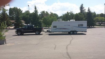

Finally had a chance to get the new blue ox and shank hooked up and set. Still 3/4" nose high, but if I get the next longer shank, my Ram will turn into a trencher. Here's hoping my family weight drops the nose of that thing a bit more :)
26' 5500lbs wet. Really pulls strong, Happy for now. Next truck will be an HD for sure so we can move up because this little rascal puts me over my GVWR by a good chunk.
Fender measurements before hookup F: 38.5", R: 41.5"
After hookup with no tension on bars F: 39", R: 40"
After hookup with 8 loose links F: 38.75", R: 40.75"
After hookup with 9 loose links F: 38.5", R: 41"
It still seemed to wiggle around quite a bit with 8 loose links. Gaining one more tension link seemed to clean that up quite a bit, but I only got going as fast as 80KM/h on the service road and I was bucking a 55km/h wind- so my perception may be skewed.

That's a good looking rig.

Very nice looking rig. I can not recall, did you end up with the variable rate springs or the 50%

Mike, do you have any lift on your rig? Looks like it's level or rides a lil high? Just curious. Maybe it's just the photo.

It is a little higher. The rear springs pop it up a little because they don't compress as much unladen as the OEM coils and barely compress with the tongue weight- which is why I needed that longer drop shank. The Rancho replacement coil overs up front have a 1.75" lift to them as well. But, the trailer is really low slung, so it likely looks worse than it is. In the pic it is pretty much at unloaded ride height.
